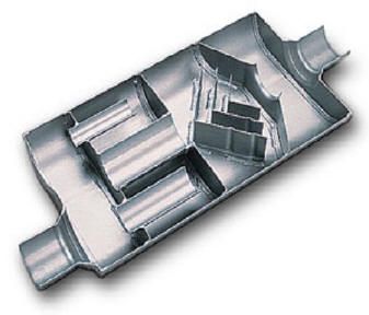

Next up the food chain are chambered mufflers. These replaced turbo mufflers as the high-end performance mufflers and are a fairly old design. They try to maintain a somewhat-straight exhaust path whilst also having resonating chambers to cut down noise. These are generally louder than turbo mufflers and around as loud as straight-through mufflers and flow a tad better than a turbo muffler. Their quality varies a lot because there are all kinds of wild chambered designs. Here are a few examples:
Flowmaster super series muffler. Probably one of the better chambered mufflers.

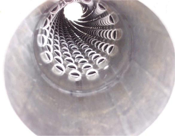

-louvered-core mufflers. These are often a cheap alternative to the high-end perforated-core mufflers. They use louvers instead of drilling out perforations. Sounds fine, except that the louvers create turbulence in the exhaust flow, meaning they're very restrictive.
This is what I'm talking about. Don't buy one of these.
