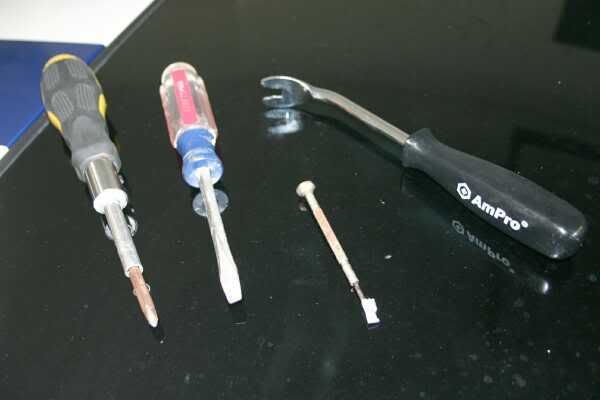

Tools you will need:
-- Flathead screwdriver
-- Tiny flathead screwdriver
-- Philips head screwdriver (magnetic optional, but will help)
-- Door upholstery removal tool (optional but worth it. ~$6 at auto parts store.)
-- Paper & pen for screw retention sketch
(Note, my tiny screwdriver has duct tape on the tip to protect the car's hardware)

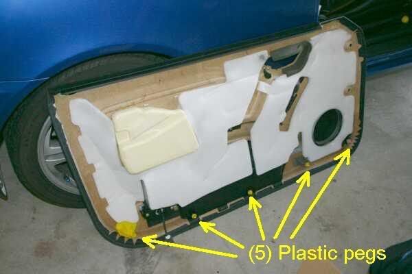

9) Once all the screws have been removed, the door panel is now held on by only five plastic pegs along the bottom edge. Looking along the bottom edge, you will see a slight opening between the panel and the door:
Inside this opening, you’ll see two bolt heads, and somewhere in between a light colored sliver – this is the edge of a plastic peg.
Using the upholstery removal tool, center the teeth around this peg and pry towards the panel. This will properly pop out the peg without breaking it. (If you don't have the upholstery tool, you can probably use the flathead screwdriver or pulling with your fingers -- all at your own risk! I recommend the proper tool.)
If you’re lucky, the adjacent pegs will pop out too … if not, now you’ve got enough opening to use the upholstery removal too to pry them too. The pegs will stay attached to the panel side.
10) Remove the panel by pulling the bottom edge away from the door and lifting the whole panel up. Disconnect wire plug for light (and for trunk release if drivers side).
Note the locations of the (5) plastic pegs.
