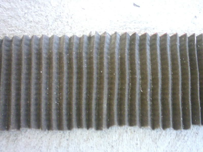

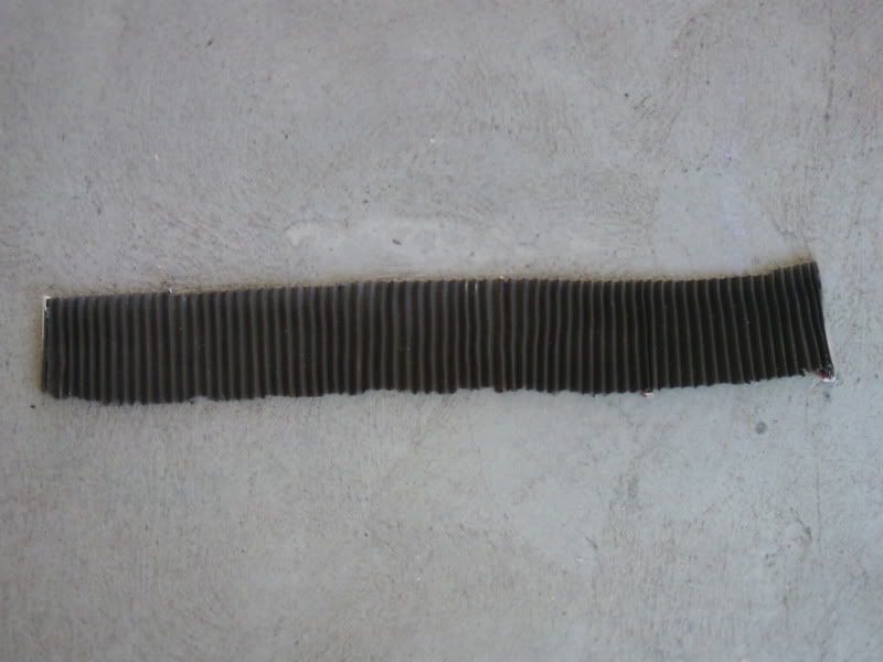

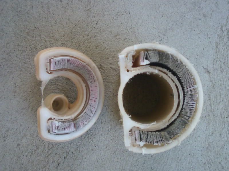

And if you're curious like I was, this is what the inside of the main filter looks like:
And here are a couple of shots of the filter media removed and spread out. Pics were taken on ordinary dirty concrete, so you can see how dark the filter got:
The white specks are just from cutting the filter in half (plastic shavings)

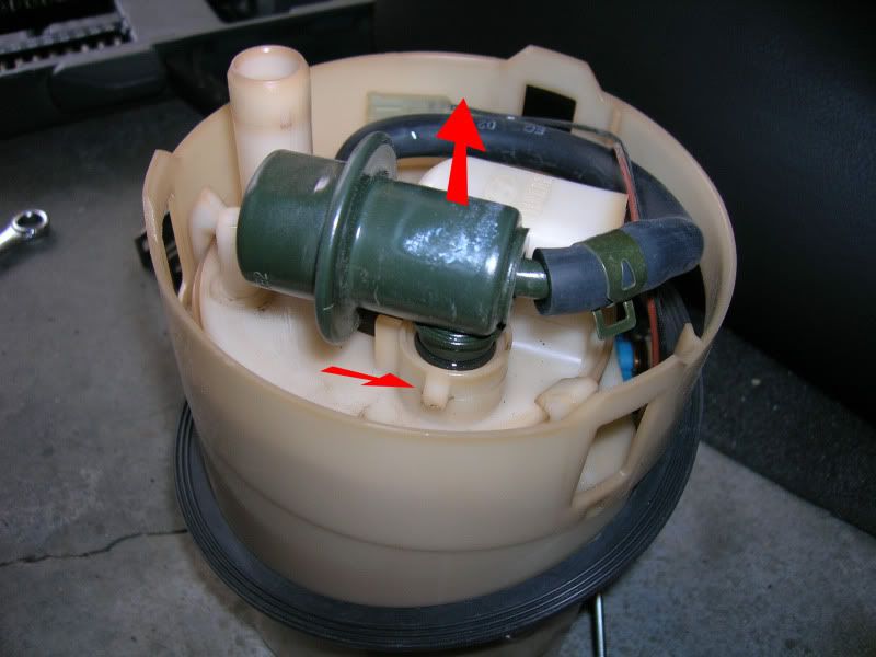

Ok, my fuel pump assembly is a bit different.... here's a pic.... any suggestions on how to proceed with this one?!?!?!?!?! ?

Hmm, not sure on that one. There's got to be some way to get that out of the tank, but it doesn't look like yours is held in with screws or bolts. There must be some way to get that black housing off of there, maybe it's held on with clips or something?
Good luck, hope you can figure it out.

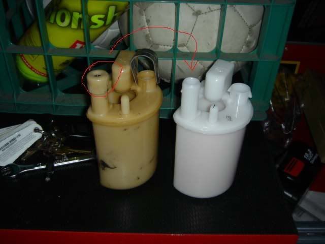

I realized that I didn't really post a good pic of just the main fuel filter. Here's one showing new and old filters with the cap and washers that need to be moved to the new one as mentioned in my steps above. (pic was from Elantraxd.com forums). If you're doing fuel filters, make sure your replacement looks similar to these:

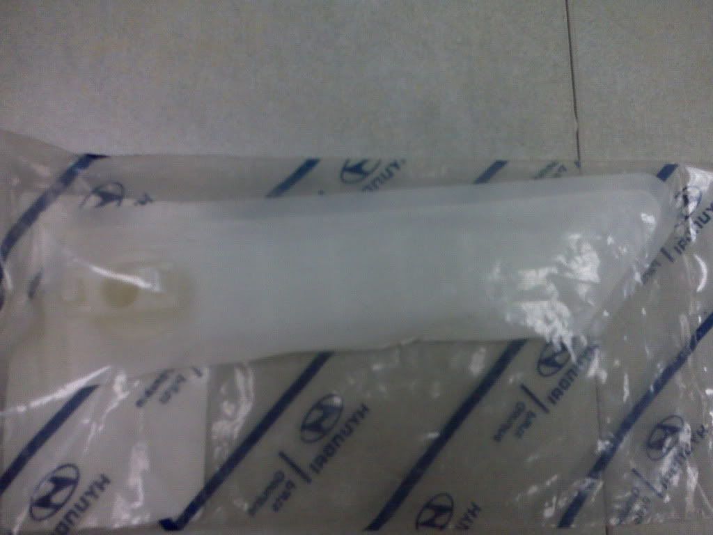

ok, question... I got a totally different looking suction filter... here are some pics.
any idea is this thing would work... I have not taken the pump apart because I don't wanna put it back together with the same old suction filter...

Yeah I don't think that one ^^^ is going to work. As you can see in my pics the suction filter is basically the same round shape as the fuel pump assembly. It has a big hole that fits on the bottom of the fuel pump, and the small hole has a washer inside that grips a metal post on the bottom of the fuel pump. I can't tell from your pics if yours has the same setup. If it does you might be able to attach it, but you'd have to bend it up the side of the fuel pump or something to get it back in.

ok... seems that this filter is out of stock in the whole freaking country... would it be really bad if I just change the "filter assembly -fuel intake" filter and leave this one on while it is back in stock?
My A/F mix is VERY rich... I can smell the fuel on the exhaust... and I think this could be one of the main reasons...

Well you can't do any damage just changing the main filter and not the suction one--obviously it's easier to do both at the same time while you're in there but you won't hurt anything.
I would think though that if you have a clogged or dirty fuel filter it would cause you to get less fuel than you need in the engine, and therefore run lean, not rich. And if you don't have a check engine light on then your mixture is within the proper range anyway.

The sock filter is just a screen. Not really much of a filter. It does keep the larger junk from going in to the real filter, the one that catches all the little things. So yes you will be fine by not replacing the sock. and if you want you could always just shake off the sock to get those larger particles off. If you see lots a junk on that sock its likely you have more in your tank.
Good Luck.

What year is your Tib? I mentioned that the 03-04 is probably different because it had a returnless fuel system and in 2005 they switched to a return-type system. That's probably the difference, and if so the filter would be different as well.

yup, thats it, Mine is an 03. I ordered what I think is the correct filter but so far they have got me the wrong part 2 times even though they had my VIN

Yeah, if you look at my post a few up ^^ showing the old and new filters yours probably only has one open "port" on top instead of two. I'm not sure what the part # is though. If you can get the right one post up the part # and I'll update the DIY.
