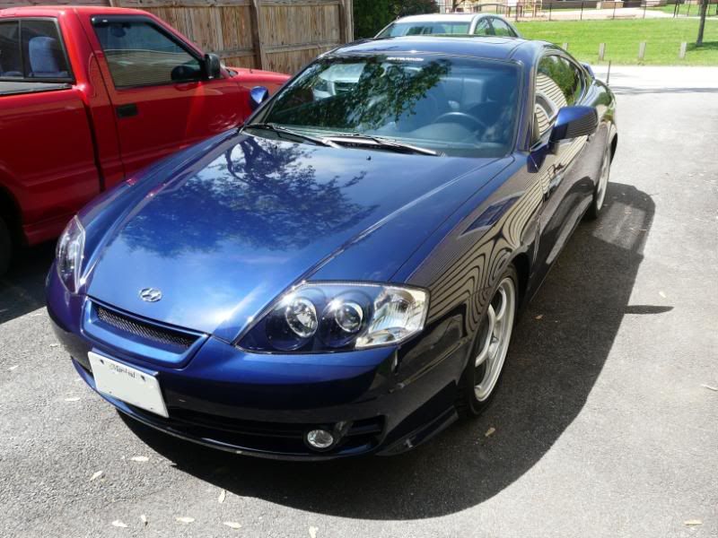

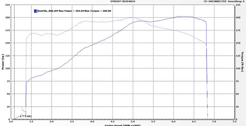

Here it is...........
1/4 [email protected] MPH
202 WHP
200 Ft Lbs.

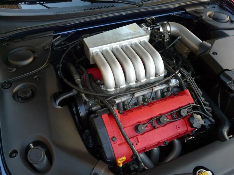

Engine:
- AEM cold air intake
- Borla cat-back exhaust
- Hotshot headers w/ high flow cat.
- Crower cams
- Tigerlily 60mm throttle body
- NGM stage IV upper & lower intake manifolds
- NGM ECU reflash
- NGM adjustable fuel pressure regulator
- Yaya poly engine mounts
- ARK lightweight crank pulley
- Fidanza lightweight flywheel
- Centerforce Dual Friction clutch
Transmission:
- Phantom Grip LSD insert
- B&M short throw shifter
- Kartboy poly shift linkage bushings
Suspension/Chassis/Brake:
- Eibach Pro-System ( springs & struts )
- Eibach 22mm rear sway bar
- APE Motorsports traction bars
- OEM Hyundai KDM front strut bar
- RRM rear strut bar
- Yaya poly sway bar bushings
- Enkei RP02 lightweight wheels (17x7, 15.2 lbs)
- Rotora stainless steel brake lines
- XG 350 2 piston front calipers
- OEM Hyundai 12'' drilled rotors
- Ingalls adjustable rear control arms

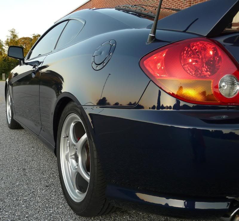

One of the CLEANEST 03's on the boards...and that's coming from my OCD opinion!
Still looks so clean after 5 years. Rep points awarded.

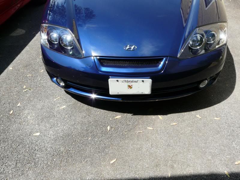

Wtf, how are your headlights so NICE? Mine are starting to do that gay clearcoat crap...

whats with the cut upper radiator hose ? the car looks clean man, real clean
how many miles on it now?
Premium Member
3,006 Posts
Discussion Starter · #11 ·
It's got 25k miles on it now. That's a greddy water temp sensor adaptor in the upper radiator hose. That's where I get my temp reading for my autometer guage. There is a sender in the bottom of it.. It's easier to use that that try to tap the stock location.

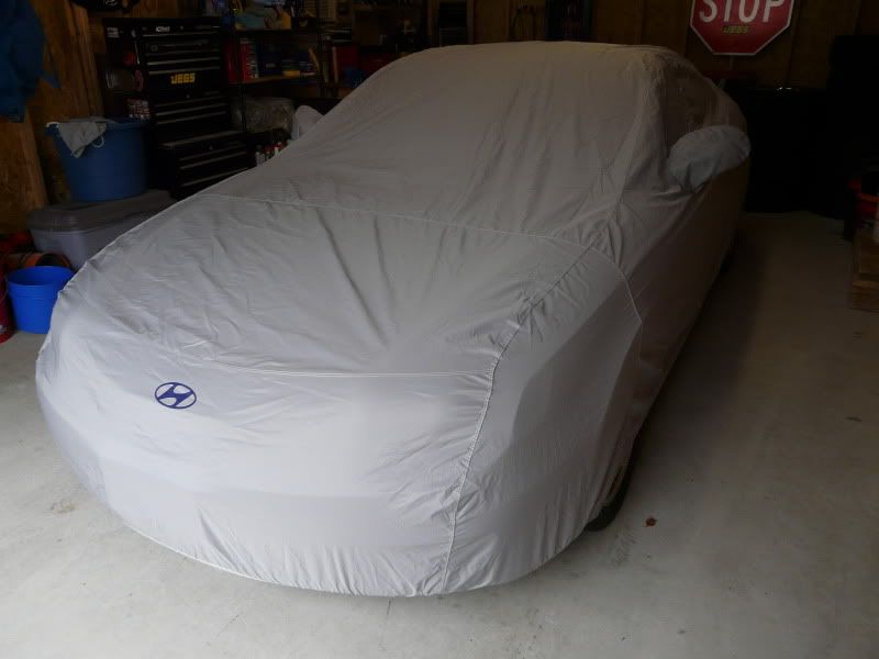

ooo nice ride. i wish i could baby my tib like that but i like driving it way too much ;)
I actually drive it pretty regularly, I just don't have to drive it to work. If it's a nice day outside, I usually at least take it for a short drive somewhere. I don't like to let it just sit for too long. On bad weather days though, it doesn't go anywhere for any reason. That's what the Sonata or work truck are for.:3_wink:
