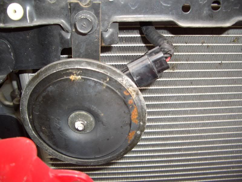

First pop the hood and disconnect the two horns behind the grill and beside the headlights. (I have my grill removed at all times so it was easier for me.)

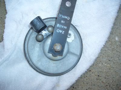

Take off the top bolt holding the horn and bracket onto the frame and turn the horn over.

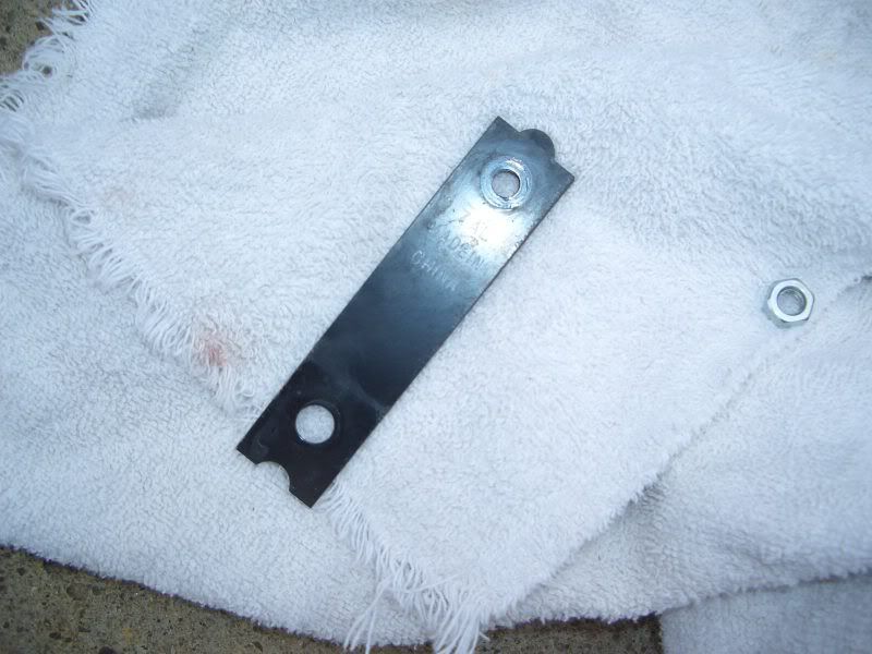

Disconnect the smaller bolt holding the horn to the bracket and set the bracket, nut, and locking washer aside. Do this to both horns.

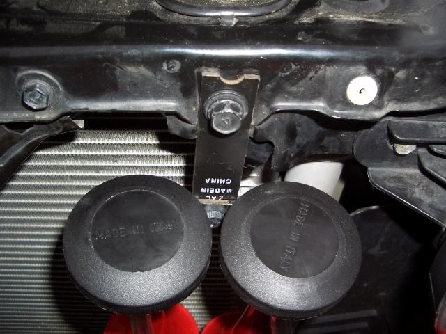

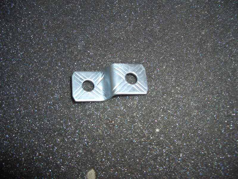

^^^Drill a third hole in one stock horn bracket (in the middle) large enough for one of the screws to be slotted into it. Once this is done connect the brackets in an upside down T using the center hole that was just created.

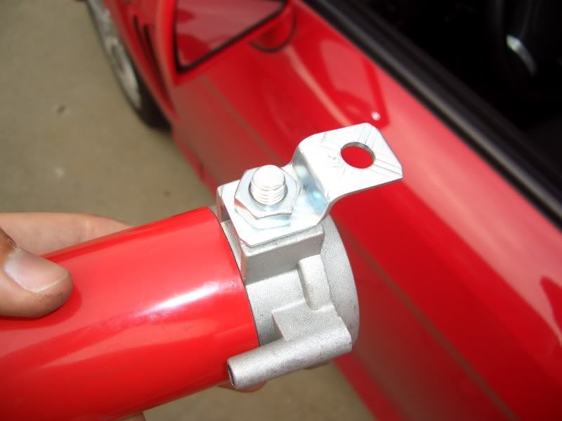

Set the horns side by side with the old bracket from one of the stock horns laying across the two, use the mounting hardware supplied and the locking washers from the stock horns to hook both horns to the bracket. the two horns should be hanging down with the one bracket sticking straight into the air. reconnect to the frame using the stock (black) bolt.

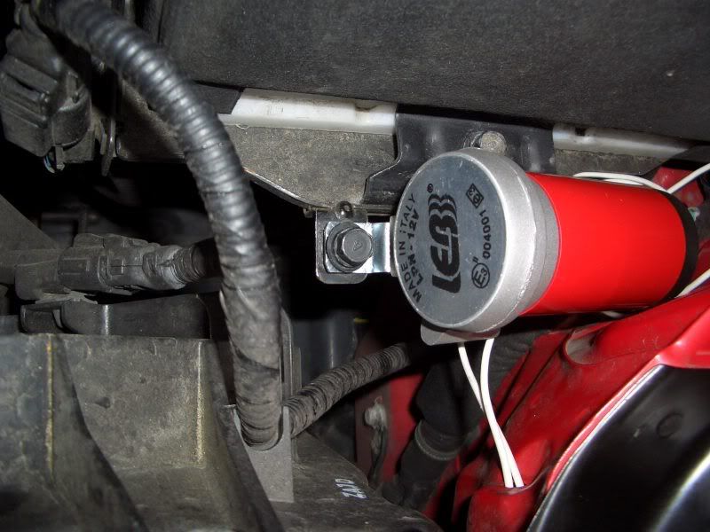

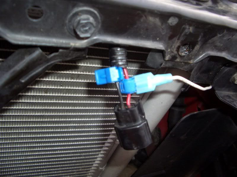

Now take the wiring for the stock horn, and strip back the tape and the plastic cover so you can see a red and black wire.
Splice into the red and black wires (I used T taps that you can buy at autozone) and run enough wire to your compressor.

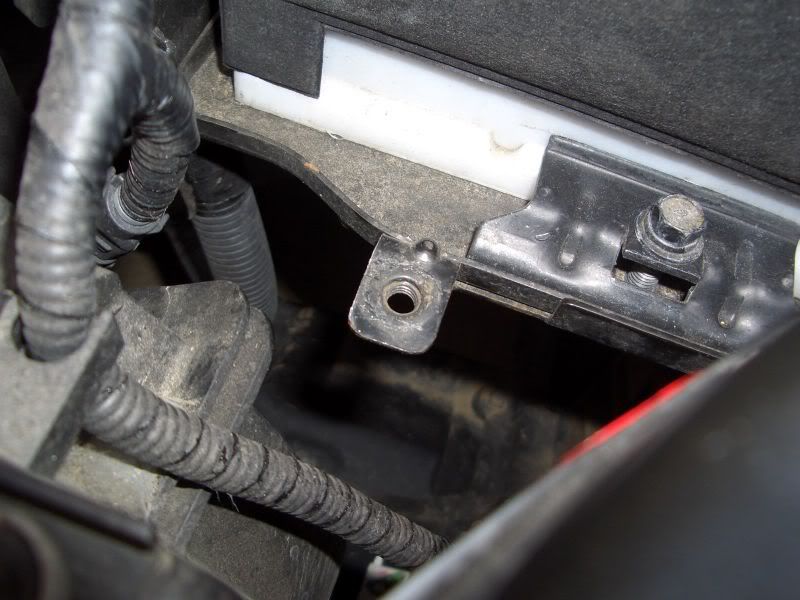

I mounted mine in front of the battery. there is an empty threaded whole (which convineintly fits the other top black bolt from the stock horn bracket.
To do so, take the given silver bracket....
(you must drill or dremel out the holes to fit the larger bolts.)
Attach the bracket to the compressor first
then attach to the open hole infront of the battery. Attach your power and ground wires before you bolt it down.

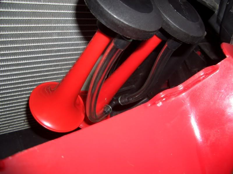

now cut the clear tube give and connect from the compressor to the Y adapter, and then to each horn. Use as little tubing as needed, this will make your horns work more efficiently and quicker.
Test your horn and enjoy! I put some electrical tape over both of the now useless stock horn hookups and ziptied them inside the frame so the would be out of the way.
This will only work for the dual air horn setup. The instructions say to mount the compressor upright but mine works on its side.
