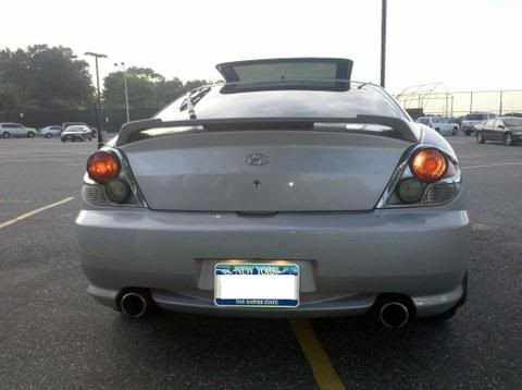

So... now I've got the emblems on my Tib. The back "H" logo is pulled off the exact same way as the front.
The "Tiburon" at the back is just stuck on. I used the cable ties to cut through the gunk and it worked great, got "Tiburon" off in 1 piece. Easy as pie... and the emblems are cheap. I say go for it.
