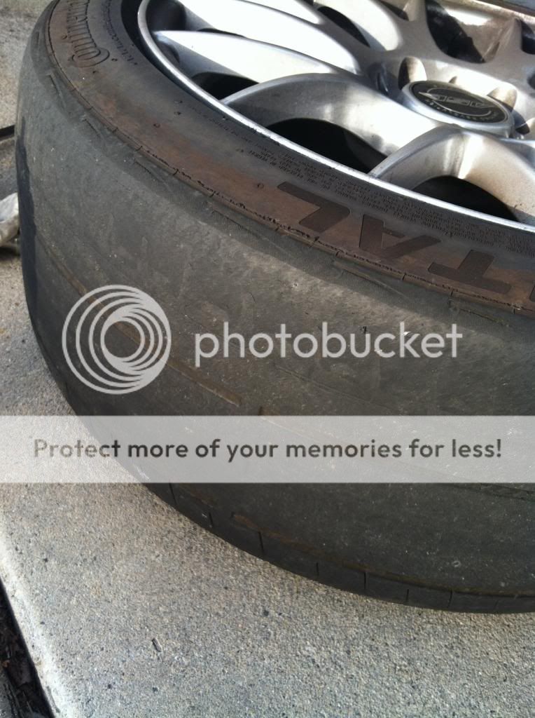

I then had a set of the Hankook K110 V12 Evos. Loved those, but killed them too in two years. Stepped it up to Continental DW’s and WOW! Sticky, consistent, predictable and silent for not much more money. Great tire.

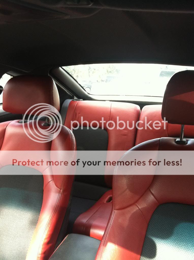

(2013) Seat Reupholstering. This was probably one of my favorite changes I made to the car. I always hated the gritty, black and grey cloth seats that came in the car. The SE leather from the ‘07 tibs was like eye candy to me, so when I found a set for sale in the FS section, I had to jump on it. I bought the leather skins from YZrider143, and shortly after, these were waiting for me at home.
Great! Now for the hard part. Time to remove the seats from the car, tear them apart, and reupholster them. This was beyond tedious. Since I needed to get to work, I had to only do one seat at a time so I could still drive the car. Even still, taking the seats chassis apart was pretty simple. I just followed the DIY on this site. The downside: I broke one of the seat backs. That sucked.
The skins come right off once you get all the clips off. But now comes the really hard part. These damn hog rings are everywhere, and they are even harder to get back on once you fit the new leather. There is no clip on and off. You have to bend the metal using pliers or a screwdriver. Bane of my existence these things were…
Fortunately, once you get the technique down, it’s not that hard a task. After a few minutes of swearing, the skins came right off.
As do the cushions themselves…
Do everything in reverse and WAHLA!
Absolutely gorgeous. You can see where I broke the top of the plastic backing on this one....and there's a kitty. : )

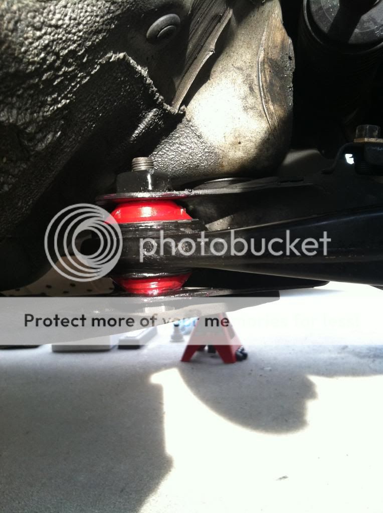

This past summer of 2013, I noticed that my rear trans mount was torn quite badly. So, after patrolling the for-sale thread, I acquired a set of kspec motor mounts from two separate members here on NT. The rear is a full poly solid mount, unlike the front which is hollow polyurethane. The yellow insert in the picture was sold later. These really helped a lot. Contrary to popular belief and advertising, these do not put more power to the ground, but they do significantly change the way the engine responds to your imputes. Shifting feels a lot more direct than before with the torn mount and the throttle response is fabulous. At the same time, I also installed some polyurethane shifter cable bushings and TWM shifter base bushings. Highly recommended, especially for the price. All three of these are included on my list of “Top Ten Reasonably Priced Mods.”
