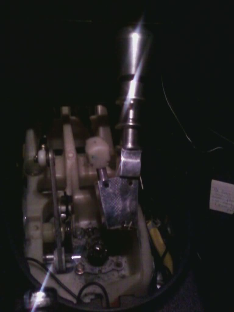

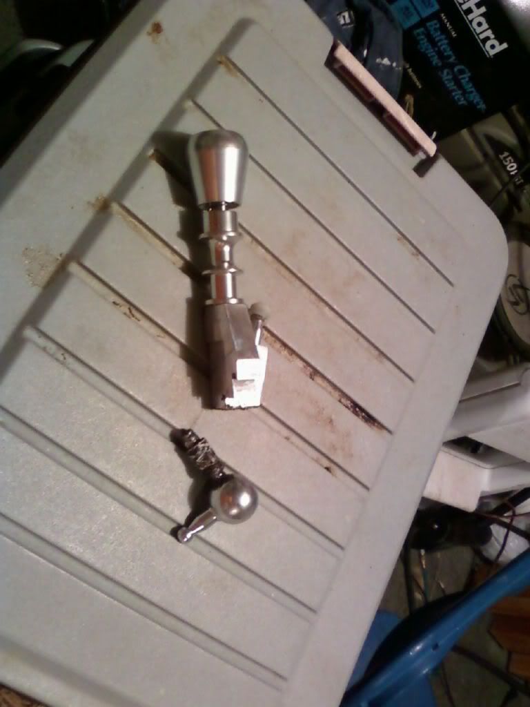

My shifter just broke while slowing down down shifting into first at a stoplight....
Allen screw broke off.... :3_steam:

yeP! lol jk no i don't think the allen screw was tight....

I felt it get loose a couple months back went in and tightened it and I think that its just Low quality-Ralco RZ is the make... I wasn't doing anything I wasn't suppose to be but idk if the bushings also had wear on it but who knows... I got it fixed up til I can get to denver to get my stock one...

if nothing can be done with the broken one, just cut your stock one.
I did that to mine. Picked the right height I wanted, cut, re-thread and if you have a 6speed theres a little modification needed on the shift lock but it's easy because it's plastic. And done, custom shifter for basically free. Mine works great just like an STS from online without the 60+ pricetag

Oh jeez guys... No I wasn't down shifting fast or at high speeds and I also Doubleclutch when I down shift into first.... So I just idk what happen the allen screw just broke I had to take off the shift cover and shift down by the lock out to make it work but i got home got a longer allen screw drilled a little hole screw Allen in and its all good now but I am putting my stock shifter back in next tuesday... But anyways... Everything is fine didn't hurt the car at all so any other ?'s lol.... I might weld it after i get my stock shifter back in just weld all the joints and it be way better... lol
