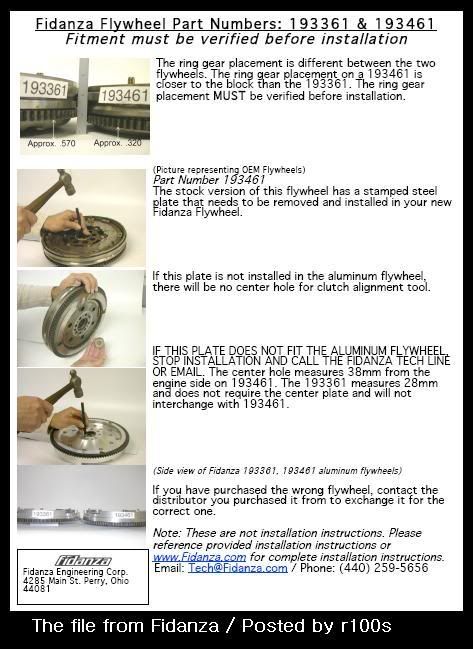

This may be a repost but since I have been getting PMs asking on this so I decide to post this info so that those of you with 2003 GK27s can figure out.
I have converted this this to a JPG file for easier and faster viewing but if anyone needs the original PDF file feel free to ask me then I can email the PDF file foir you.
Kenny(r100s)

Thanks god Fidanza finally put something out on this.
Here's a sticky for ya.

How does this affect other years? Like my 2005, or is it specific to 2003 models?

I found this the other day other day while I was figuring out whether I needed the HY3 or HY5
* 2003-2005 Tiburon 2.7L
SPECIAL NOTES: ALL APPLICATIONS ARE LISTED USING THE VERY BEST SOURCES AVAILABLE. THE END USER MUST VERIFY FITMENT BEFORE INSTALLATION.
Please make note of your cars manufactured date located on the drivers side door jam before ordering.
- Manufactured on or before March 2003 (5-speed): HY3-193361
- Manufactured on or before January 2003 (6-speed): HY3-193361
- Manufactured on or after April 2003 (5-speed): HY5-193461
- Manufactured on or after Feburary 2003 (6-speed): HY5-193461

Findanz states that most of V6 tiburons out there may follow the fitment as the above but there are some V6s font follow that. ( For 2003 V6)
Our shop had worked on a 2003 V6/6sp which the production date was in november in 2002 and we found out that we needed to use HY5-193461.
Best way to find out is to see what you have on your car first to verify which flywheel you have. So does mean you open disamount the tranny? We actually found out by removing the starter motor and looked inside to comapre with the pictures that Fidanza provided. and then we had ordered the right part for the car.
Good luck~

No tibs used the hy-3. It was a mistake on fidanza's part.

Explain the difference between the two. Maybe a stupid question, but does the HY3 have a greater diameter or something than the HY5?
Not to be a d!ck man but how do you have over 3000 posts and not know the difference between the HY-3 and HY-5? It one of the most covered topics on NT. Anyway the difference is the spacing off of the crank. The HY-3 sits further away from the crank then the HY-5 does. If you use an HY-3 when you're supposed to have the HY-5 your starter teeth will not line up with the ring gear on the flywheel correctly.
+10
I used to own a 2003 GTV6 with a November 2002 production date and it too required the HY5-193461 part number.
I do remember though that there were a few people who had REALLY early production models like SPRING 2001 that used the HY3.
But who knows where these guys are. Probably sold their cars and these poor 2nd and 3rd owners haven't a clue and will be consumed by the curse of HY3!
