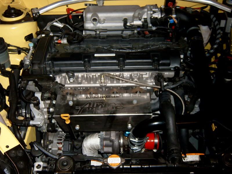

I ordered the entry level kit and 2 weeks later it arrived at my shop.It only took around 5 hours to install.The only problem I had was with the wiring harness.The car would not start.After a few hours we thought there was something wrong with the unichip.Dave and John talked to me the entire time while trying to diagnose the problem.They sent me out a new unichip and harness overnight.I got the car running the following day and have had no prolems with the kit.This kit is good for those that want some added power without goin broke and it is very upgradable.I heard some people having some problems with Alpine before but I can't say the same.I was updated thru out the entire time about how my kit was coming along and whenever I had a question it was answered promptly.

You didn't have any manifold fitment issues?
Looks fantastic man, congrats on t3h b00st!

MrPhotoman said:
Your engine looks great! When do you plan to dyno and hit the track?
Probably this spring.
Gamz-no manifold fitment issues but I did have a problem with the wastegate actuator hitting the trans bellhousing.A lil grinding down of the bellhousing did the trick

71 Posts
so I read through the whole thread over this Alpine turbo kit. Does it fit the 2000 2.0? The pic in the first post looks the exact same as my motor but mine isn't turbo yet.
Also... I haven't looked it up or anything but what is cvvt?
I have a OBX turbo manifold for a t3/t4 turbo already. I had the head to my 98 Tiburon out, that has the same motor as my 00 and the manifold didn't line up to the bolts. Should I just go ahead and forget that manifold and get the alpine set up? I'd like to boost around 12psi to start. My friend is at 24 right now and his car is INSANE!!! Let me know!
