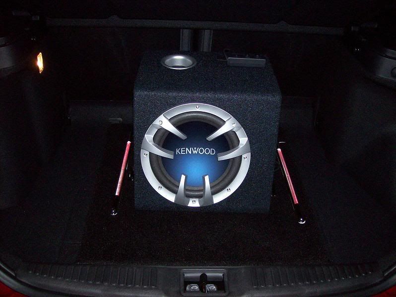

Finished product as viewed from outside of the hatch. This is an all-in-one unit, subwoofer, amplifier, and box came together.. a total of 200 watts of bass, and to me, it's plenty enough if you're not into competition.. inputs are RCA from the factory pre-outs, obviously remotely turned on by the head-unit (I also linked the LEDs to the remote turn-on), and power is made from the above-seen wire to the power wires that came with the system (18ga with 5A fuses apiece). Grounding was done by removing a bolt under the passenger seats, sanding away any paint present, and connecting there.
Subwoofer box and LEDs were mounted to a 23/32"x24"x24" board, which I carpeted using what was leftover of the carpet I bought for the custom Elantra floormats that I made. I still need to buy a small amount, as I plan to add velcro and create a cover for the wires (which are not visible in this angle, but are ever present).
