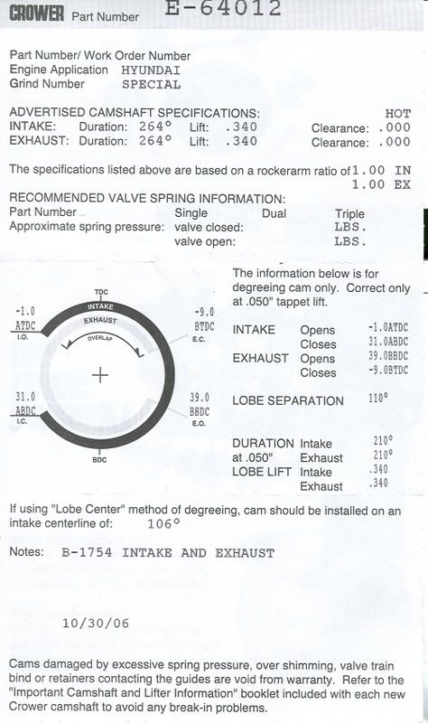

MOST COMMON SPEC: .340 LIFT .210 DURATION .110 SEPERATION
Others have used: .333 Lift 204 degrees duration @.50. and 112 degrees of separation.
.349 Lift .210 Duration 110 Seperation
Basic cam card: ie what most people have. Thanks to bluegtv6 for the card.
How to degree a cam the easy way
Cams can be bought and swapped with stock ones without any other modification. Cam gears can be purchased to either advance or retard them. Advanceing them 2 degrees will move the powerband up 500 rpms and 2 degrees retarded will lower the powerband 500 rpms. Cam sprockets will also give you more adjustability, as they will allow you to adjust the seperation.

faus leave the links in there but put some of the more important information in the first few posts... including cam cards and recommended mods to see full whp gains, prices, other places to get cams other than crower, and some dyno graphs of some of the N/A guys...

they have TONS of grinds they can do, you dont have to do the .340's. Also you dont really need a cam card, you can send them you cams with a note inside saying what car you have with what engine, what you have on your, your telephone # and they will contact you with their grind they would like to do.
I have decided on my grind and will be sending them out within the next couple of weeks. I will also mic them when i get them back to make sure they are what i paid for. The ones i am getting are .358's.
