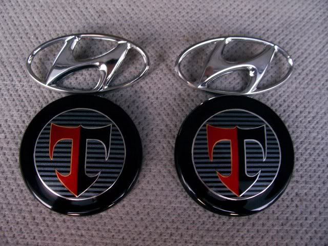

Eventually, the holes in the front will be filled and painted, along with the rest of the car. The back will get a custom "T" logo from ForceFedFlesh. Or I may just have those filled when I have the holes from the spoiler filled. As cool as ForceFedFlesh's badges are -- they are works of art, they really are -- I think I like the plain look in the back. I might buy one of his badges just to have it, and not even put it on the car.
