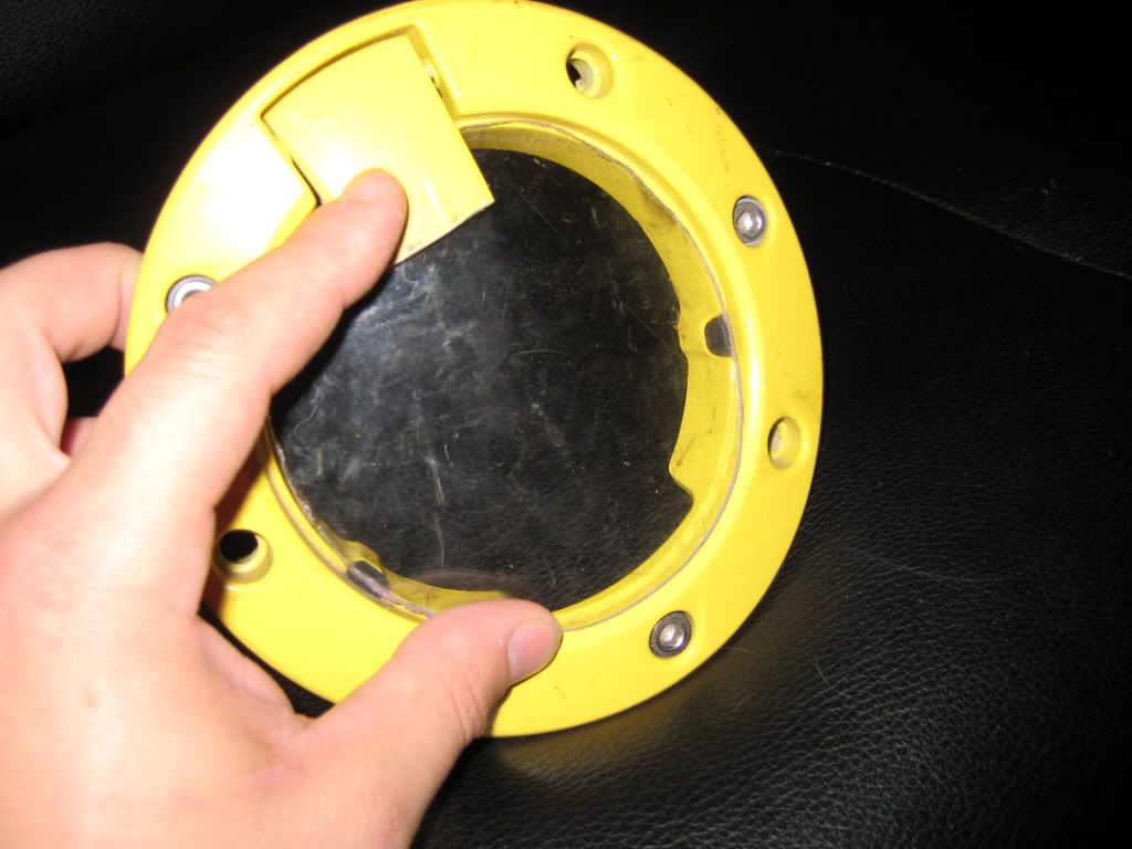

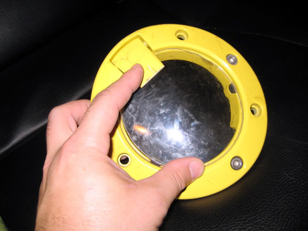

Ok so i have been tossing around the idea of making my own clear fuel door, since they are no longer being produced on the market. So here is how i am starting, so this is a VERY rough fist try, i figured out the basics, what i will be doing is using some high grade Lexan plastic, so for one it will be more resistant to weather. So what i did was free hand cut a round piece from a scrap piece i had here, just to try i out, and i had a spare fuel door lying around, so after cutting out the circle (no perfect) i heated it with my heat gun and curved it to fit. The next one i will be doing will be cut with a proper 4.25 inc hole saw for the proper diameter, and it should look mint! PLEASE KEEP IN MIND THIS A ROUGH FIRST DESIGN.

ok so here is a bit of progress, a perfectly shaped circle, now installed. the issue i have had is trying to glue it, i have tried 3 different types of glue including epoxy and nothing seems to work well, so i decided to use small screws, so for now it works, but i would like to replace the screws with a "FLAT" style screw so it looks flush, i have seen them before, i have to pick some up.
