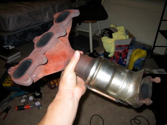

actually, all you need to do is replace the rear cat. the car will function fine with even one cat. pick up a magnaflow cat from ebay and have it welded in. should cost you less than $120.
leave the one in the headers alone.
each exhaust manifold looks like this
"Pics removed to save space"
3 cats in total. The things wrapped in the silver heat shields are the cats.
