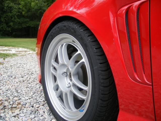

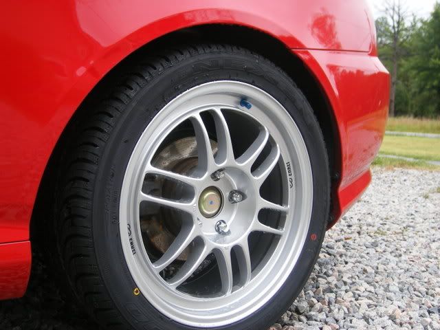

Oh, and they fit.
The fronts definitely 100% OK, although it's VERY close but it's a perfect close if you know what i mean.
The rears have clearance but require the fender lip to be bumped up at a 45 degree angle which provides sufficient clearance. Doesn't require fully rolling the fender lip.
SO for the record....
17x8 et35 w/ 235/40/17 tire on Espiler drop will NOT rub in front and only requires slight rolling in the rear.
Stance = bad@ss!

Oh, and they fit.
Stance = bad@ss!
Grip = super duper. (I can't spin 1st with the clutch/flywheel from stomping @ 3500rpm like before)
May have to take it to the track and see what she'll run.

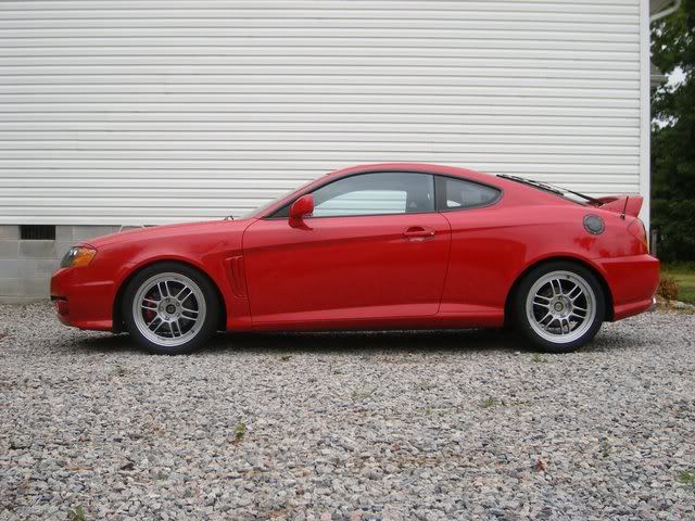

wow, looks great!
i totally called it in WayTooFast's thread about the rolling at the top of the fender in the rear, LMAO.
Espelir are how much of a drop? my car is a least a 1/2'' lower in back on a full pro kit; i would not be able to fit those.
#27 · (Edited)
Thanks man.
The drop i believe is 1.5" front and 1.2" rear. I'm pretty sure about those numbers and absolutely positive it's a staggered drop with the front being lower than the rear.
Oh and the factory 215/45/17 tire size filled in the gap slightly more in the rear as it's a slightly taller side wall than the 235/40/17. It's pretty dang close though, but just a smidge shorter. Probably for the best as I'm on the threshold for fitment with this setup. Maxium grip baby.
