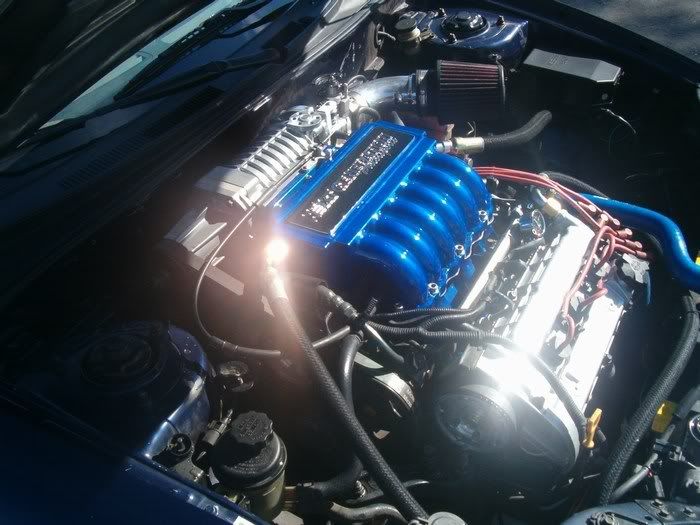

Well, me and Lostdestiny and Minesbetter got my pig running lastnight .........and man does it sound pissed. The car hits 16.5 lbs of boost without even gettin on it hard ,I really couldnt get into like I wanted because my TPS is FUBAR'd......But , I have another one so I should be able to dial it in tonight and see if I can go out and scare some vipers again tomarrow night , this time I can take one of the guys with me and get some good video kills :D

how does the tps affect stuff?
i really have no idea how that works
The ecu uses the throttle % to gauge how much fuel to stuff in the motor along with maf signal to meter the air to fuel mix , so without TPS signal it will just add based on the amount of air passing the MAFand that aint as fun as it sounds as mine now runs based on MAP and RPM &TPS.........I gave it a little quicky road test and A guy from the neighborhood came up beside me in his Skittle(SRT-4, and he's a pretty good guy , Ive' raced him before) he wanted to know why it sounded like I was swingin a cat around by it's tail under the hood , I just wiggled my eyebrows at him and he smiled and laughed and said it was about time. Anyways he wanted to see if we made any improvements, light green I just blipped the throttle to 4k in 1st,2nd, 3rd and popped him about 6-7 cars(granted he only runs low 14's) but it was cool to see even untuned the car is pissed . So this weekend I'll be replacin the TPS and gettin the pig dialed in and yes I will start doin the Vids on it :D

So are you hittin those numbers with a 60mm TB?
Yeah JB and I just found out that I've got the wrong signal wire tapped for the tach signal (I plugged into the same one that were usin on the MAfterburner....Wrong!)So that explains the wrong fuel trim and weird throttle response.......as far as Whp, right now because of the 60mm tb I'm only probably gonna peak 360-370 till I get the 90 mm on it (kinda like suckin a strawberry from a McDonalds shake through a straw) lol

I thought the whole drama of the Assassin is that nobody could really get much over 300whp without a TB much bigger then 60. How would you make so much power if nobody else could? I am not being a jacka$$, I am just curious where the biggest differences are.
Re: Finally, it's alive
Oh ,no problem .......I think the difference in this case is that I'm using the MapEcu2 instead of the Mafterburner, I wont run out of Maf signal on the topend like the others before, that and the fact that I'll be able to put in a timing table to advance it where we keep loosing it during hard accelleration boost........Remember that the MapEcu adds based on manifold absolute pressure so if it's capable of hitting 16+ lbs then it should be able to add fuel accordingly:D

You have it already?????
The MapEcu2?........yes sir :D along with the Bosch igniters and inverter, I'm just waiting for the new firmware to download in the Mapecu for the higher rpm loads
