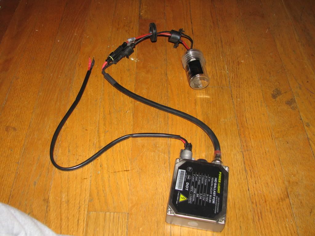

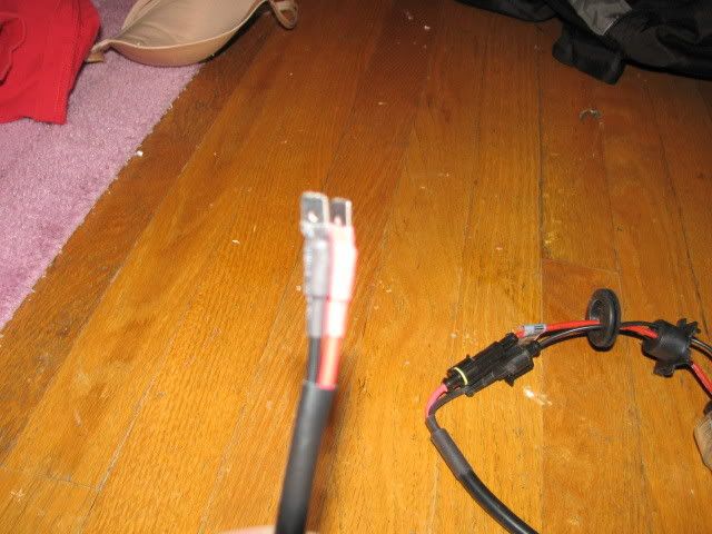

I have 04 headlights in my 05 tib. They have LED angel eyes and I have HID's to put in them. The problem Im having is how to make the halos work with the 05 harness and how to install the HID's. Ive looked at almost all the DIY HID listings on here and the only thing I dont get are the two wires (black and red) that have the metal ends on them. Also I guess I need the relay but know nothing about that either. Ive done HID's on my old Tib but these have me stumped. Please HELP!
you can run your "ON" signal for the halo's from the corner lamp. I'm assuming you have all ready swapped over your internal head lamp harness? If you have not, then you will need to do that. You can run the wires out side of the lamp to get to the corner lamp wires.
As far as the HID kit, just use the connector that plugs in to the back of the OEM bulb for your "ON" signal.
It also might help if you post pictures of the HID and halo kit you have.

you can run the red and black wires back into the head lamp to the connector that is plugged into the OEM bulb.
Now for the Halo's....I'd guess those wires (green/white) are for them. You can take a 9v battery and test it.
Now since you want to run them to a toggle, extend those wires to inside the car.
You will need to put your 05 harness in the 04's though. If you have not all ready. This will not affect the HIDs.
2 confusing wires
not to be immature about it but ur bra is showing, and those two wires you going to have to find would which is the ground and which is hot from the looks of it typically the darker color is is ground so in this case it will be the green and white would be the hot wire, have u tried to connect them to ur battery to see if they work?!
if you want them to work when u turn ur lights on then connect it to the "2 confusing wires" so when u turn on ur liight not only would ur HID turn on but so would the halo's now theres a bad thing to that it would drain power to you HID and it wouldn't be as bright as they should be and it COULD maybe burn your wires which i dont think it will happen
