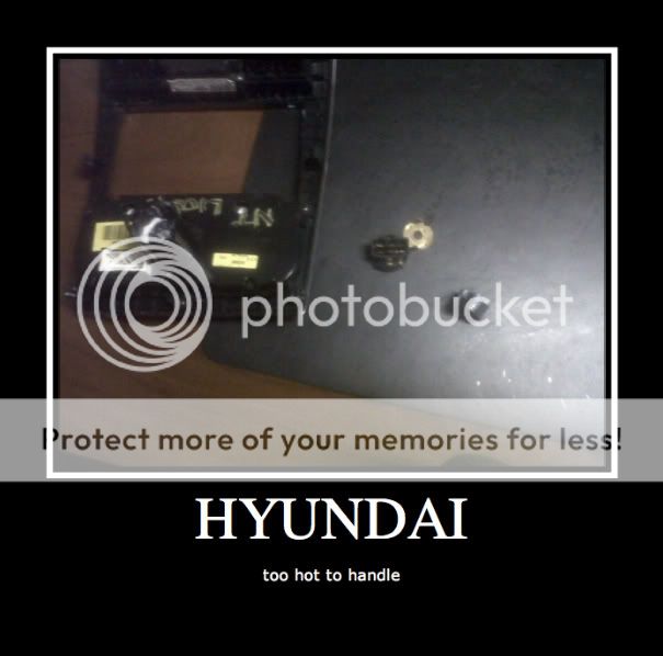

this is priceless. last night my climate control melted. HOW?? kinda hoping someone could tell me. i went out to start my car and put the heat on so this way when i get in it it would be warm. make sense right? so when i get in the car i go to turn the heat off and i felt no locking on the setting and the heat stayed on. after about 30 sec of being on the heat went off. i pulled out the center fascia and a bronze metal piece fell on my hand. HOT AS HELL!!! i noticed the plastic was bent out and all the pieces fell out. here are some of the pictures
