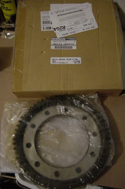

nissan maxima fd gear: 38101-8H504

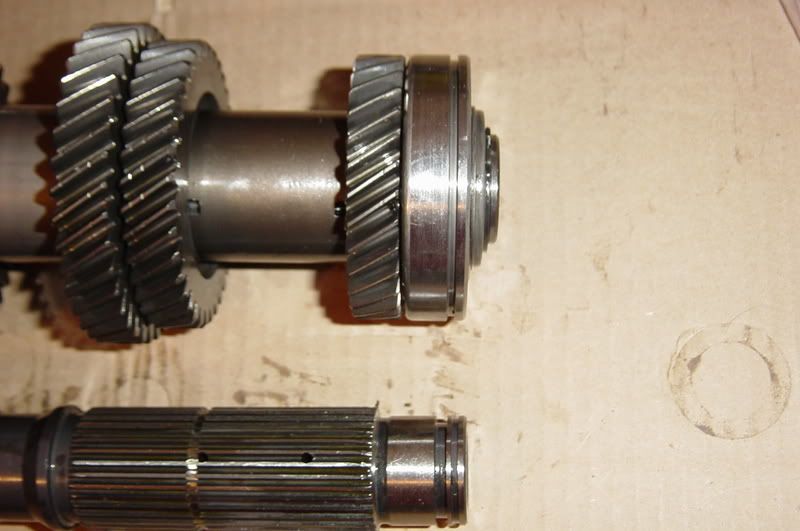

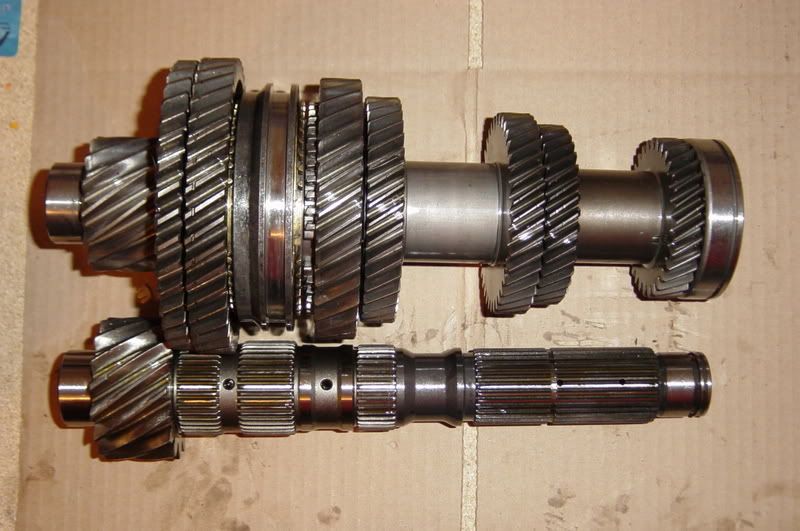

hyundai pinion w/1-6 gears vs. nissan pinion
nissan final drive gear aka crown wheel
pinion length difference (nissan pinion is the shorter one)

as for the pic... the nissan pinion is the one on the bottom-the one that is shorter and has no gears on it.
