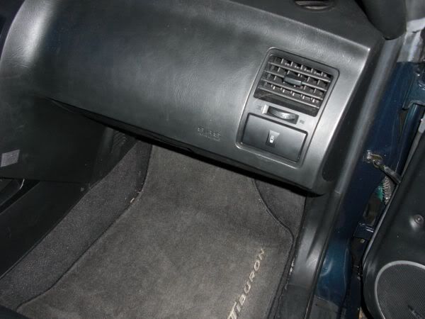

Start by removing the glove box, before you open it look at the bottom and you will see 3 phillips screws approximately 8-10 inches apart, take them out. Open the glove box and look at the top, 3 more screws, take them out. Now, make sure you've un-hooked the light at the top of the golve box, use a straight screw driver, pop it out and unplug the wires. Now pull the glove box down, there are 2 clips holding it in place, a quick snap down and they should let go and the box is in your hands.
