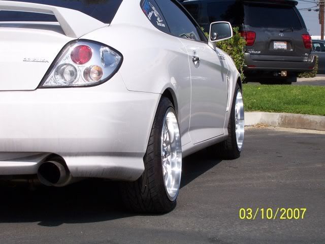

Here are some good pics though... dont know the dimesions of the wheels though...

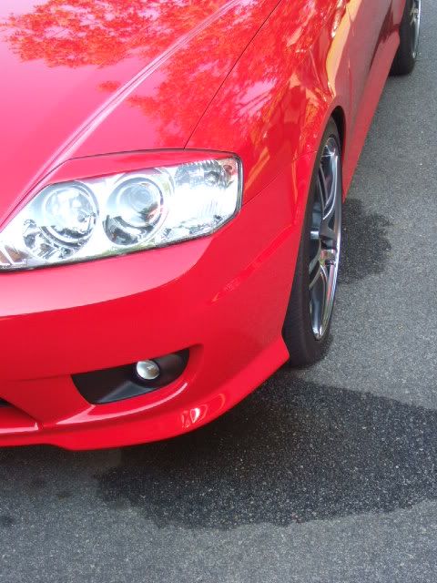

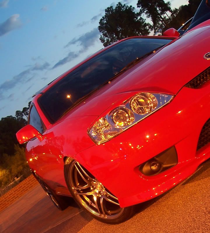

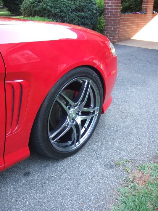

i think 17x8 with a 35 offset is perfect... I have the espelir springs, and nothing rubs. I think it rubbed once under hard braking, but I may be confusing it with the ABS flipping out.
once i get coilovers i'll add spacers to the back and roll the fenders since it'll be lower and i'll have wider tires. Part of the reason why it doesn't rub now is because i have the stock 215 wide tires on the wheels, which are a little stretched but work fine.
with 235s it would definitely rub.
pics:
