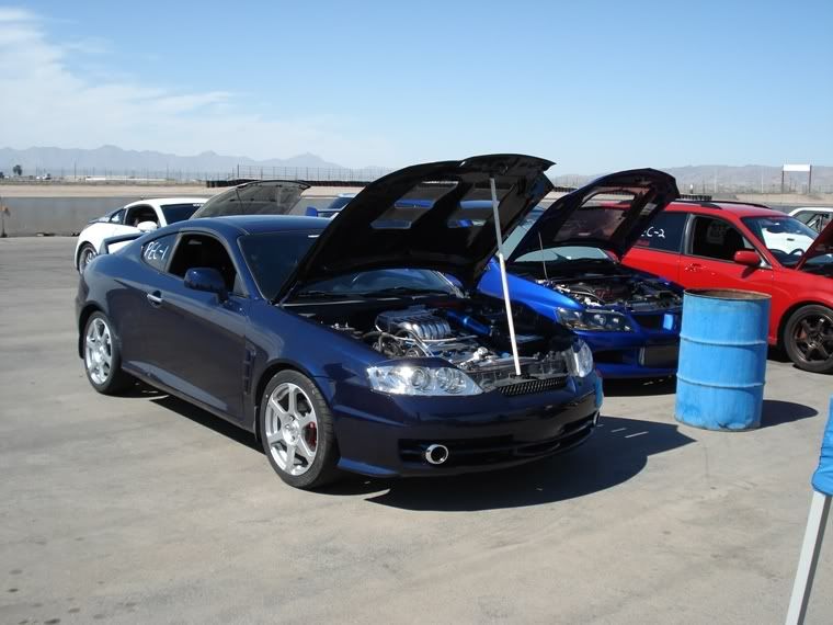

OK, so maybe not a full one race-spec Tibby, but I did take my car out to the a local track day at one of the local road courses. Just to give you some background for some of you that don't know the full details of my car:
Power: 210 whp NA beast
Suspension: Ksport coilovers, Progress rear sway bar, RRM rear strut bar
Brakes: Uneek slotted rotors, stainless brake lines, Hawk HPS pads, ATE SuperBlue brake fluid
Tires: Yokohama AVS intermediates
Other: Koyo radiator, N1 vented hood, Speedfreak LSD, stripped interior.
Basically, my tib is no longer a daily driver, and is pretty much now used for racing, and some street driving.
This was my first track day in the tib (or ever), and I can say it was definitely a fun time. They supplied an instructor for the day, who was an ex-Bondurant instructor, and taught me a lot about the lines, braking, steering etc. For all of you that think you could go out and race competively, you have another thing coming. Road racing is way harder than it looks.
I spun in my first session on my 3rd lap. My other 2 sessions went well, with the tib handling itself decently for each 15 minute session. The first 2 sessions I was pretty much passed by 90% of the cars in my group pretty easily (modified street cars under 250 whp). By my last session I was pulling on a slightly modified wrx in some competive racing.
My impressions:
1) The tib brakes suck. Even with the upgrades above, I would get some serious brake fade during the 2nd half of each session. To do this regularly, you would need a pad the is more aggresive, and probably not suitable for the street.
2) Tires and brakes are everything, and be prepared to have them chewed up pretty well.
3) Despite anything you do, the tib has alot of understeer.
4) Road courses should definitely not be attempted in your daily driver. Seeing how my car was abused by the end of the day, I would not attempt it in a car you rely on for transportation.

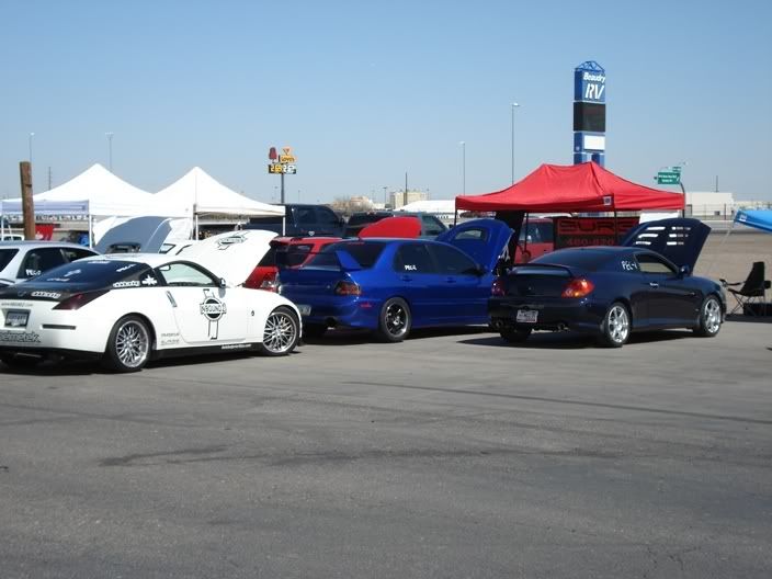

A few more pics from www.nboundz.com
