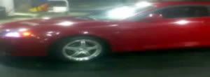

#21 · (Edited)
Here is a quick vid, my gf did not start the camera on time so you miss me spinning through 1st gear, that is why when I hit 2nd gear I am not up to speed and the rpms are so low. When it goes to the interior vid I had the windows rolled up, that is why it is so quiet.
http://media.putfile.com/75l
Dang thats awsome. I can't hear my S/C from that back at all. You can on yours. Sweettt. You exhuast isn't loud at all. Do you have a cat on yours? I just did my dyno and i am making 210whp with stage 0. I have headers and a hi-flow cat.

yeah I have ssa headers and a high flow cat. The supercharger is pretty loud with the upper pulley and I have the insert that quiets down my exhaust a little.
