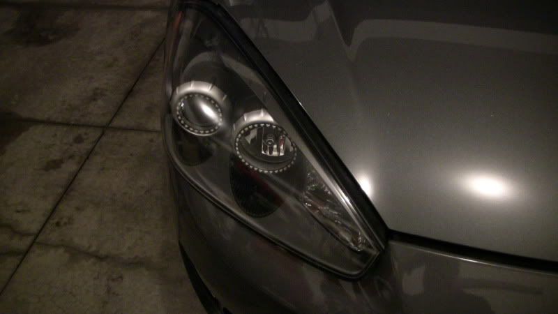

[1] First thing you want to do is check to see if your SFR angel eyes work before you install them to your headlights. Here is what the angel eyes look like.
To test whether or not the angel eyes are working, I connected the blue positive wire from the angel eye to the positive terminal of a 9V battery and connected the black negative wire from the angel eye to the negative terminal of a 9V battery.
Here is a picture of me testing out the low-beam AE:
Testing out the high-beam AE:

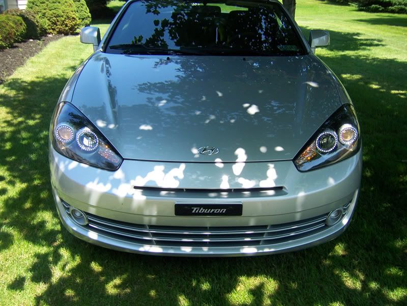

[14] Now it is the moment of truth!! Install your headlights back into your car, reconnect the headlight power connectors, reconnect your negative battery terminal wire, and turn on your headlights!! If the wiring was done correctly, you'll get a result like this!
Congratulations!! Now you've got beautiful Angel Eyes in your '07-08 FL2 Tiburon!!
Needless to say, my girlfriend is very happy and thrilled with her newest mod.
I'll post some daytime pictures later on when we have both of cars together for a dual Tibby shot with angel eyes! =)

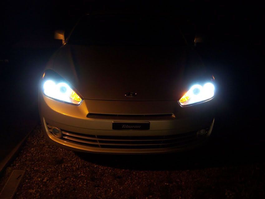

Picture of my car and my girl's car with the same SFR 7,000-K white LED angel eyes.
I was too lazy to scan this diagram I drew up so I instead took a picture of it with my camera. It shows how the wiring is set up for my '04 GK Tiburon. The concept is still the same for the '07-08 FL2 Tiburons--just the locations where you splice into the city light wires are different (high-beam light bulb compartment for the GK and inside the headlight for the FL2).

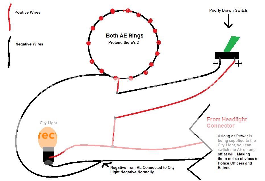

Sorry, Got bored and made this for you, Sushi.
Anyone feel free to Correct me if i'm wrong but i've done plenty of wiring in my own car so i think this is Right...and would work.

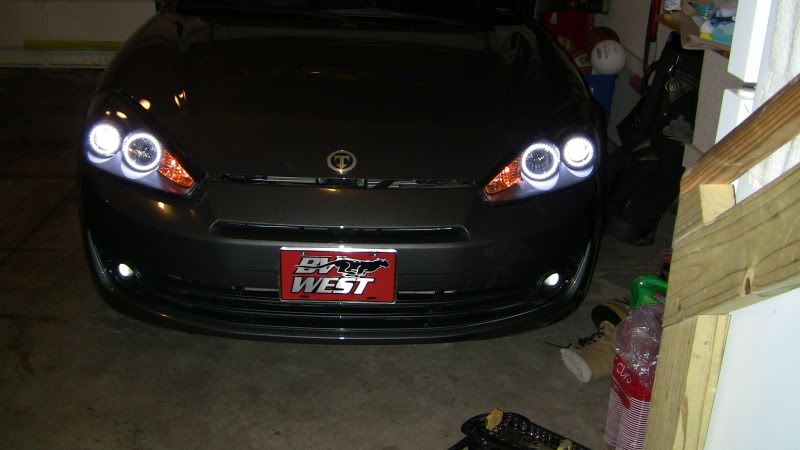

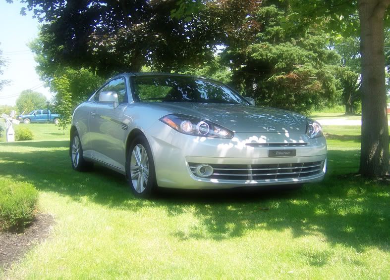

My son and I did the AE install this weekend and it turned out wonderfully. He really likes them and has been getting a lot of compliments. It took us a good part of the day to do them both, but it was worth it and I expected as much. It's cold and dry this time of year in Kansas City, so I guess time will tell if I sealed the lenses up well enough to prevent any fogging. I'll take it up to the car wash when it warms up a bit to see if I have any problems. That is my biggest worry. I did use a liberal amount of silicone and was able to snap all of the clip locations back together fully. Another concern I had was the loose wiring I had to leave inside the light bezel and the back of the module. I tried to stuff the wiring in as best I could, but there is still some loose wiring floating around. How hot do the light reflectors get? Do you think there could be a problem if some of the wiring is up against them? Melting?
Here are some pics of the completed job.
