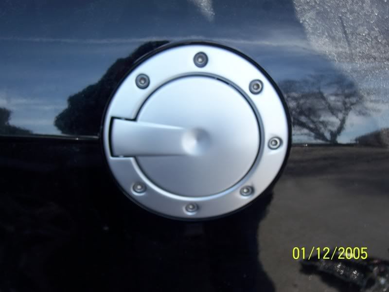

This is a exterior visual upgrade that will significantly improve the way your Tib looks and best of all...save you around $70 bucks. This DIY can also be used to remove/install a fuel door and trim...you pick. Takes around 20 minutes of actual work to do it, so what's stopping you?

Pics up shortly....here they are...ignore the dates, they're way off.
