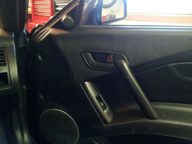

Thanks for the welcome. I'll try to keep pictures flowing as I progress. So far, a cleaning of the interior has made a big difference there. I cleaned the surfaces with P21S Total Auto Wash - my rag looked like I degreased an engine. I followed that up with some 303 Aerospace Protectant, and the plastics look a lot better. About an hour with the shop vac and a carpet brush helped clean that up, though I'm still thinking I need to replace the carpet - at least the area by the driver's feet. For now, I threw in the rubber Hyundai floormats from my Santa Fe - as I only use the rubber ones in the winter. Working on ordering a set of OE mats, metallic pedals, and the trunk area mat.

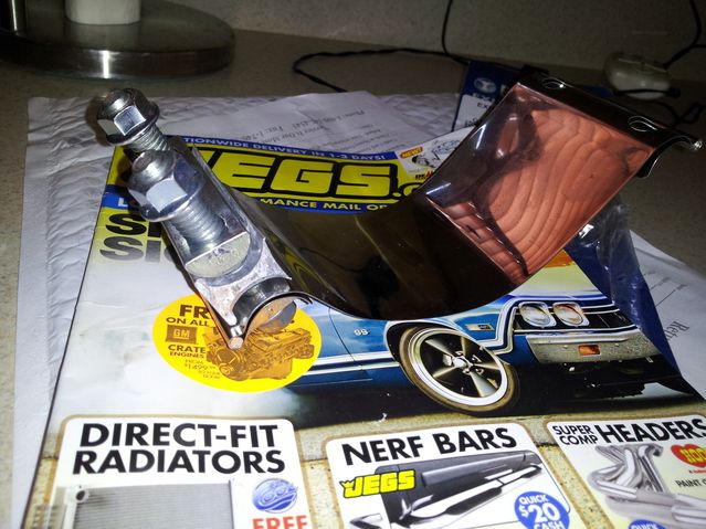

On my lunchbreak Fedex dropped off my exhaust clamp from Jegs. Some weather strip retaining clips showed up in the mail too, so I fixed the passenger door weather strip that was hanging down. I need to get the part numbers for the passenger window weather strip - it's beyond salvageable.

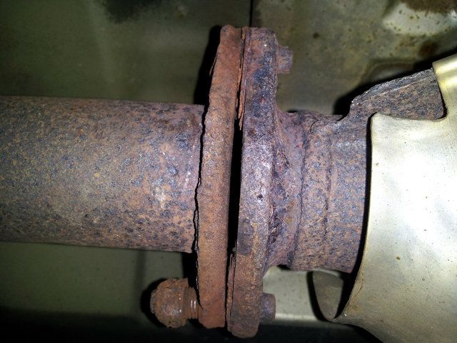

So, last night my quick 1 hour exhaust fix turned into a 4 hour fight. The plan was to cut off the beat-up flanges from both sides of the connection here:
Why? Because the one stud was gone, and the other wouldn't tighten up. The [expletive deleted] previous owner wanted the car louder, but instead of putting on an exhaust or walmart muffler, he just unbolted the cat from the rest of the sytstem. But, the cat would drag across the ground if you unbolt it, so he left the nuts on, just backed off about 1.5 inches. So, the cat banged around loose on those studs, breaking one and chewing the threads on the other. I could have heat+beat out the studs to put new ones in, but I wasn't confident I'd get a good seal with these rusted flanges.
So off it came. I started with a cutting wheel and sliced through the tailpipe side first, bottom up. Finished off the top with a sawzall and Milwaukee ICE metal blade. That was easy. Couldn't get the grider to fit around the CAT side, so I had to sawzall it all. Chewed up 2 metal blades with no progress. Off to the hardware store for an Irwin "thick metal" blade. Came back and it went though like butter.

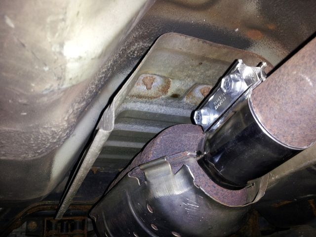

I brought out the new stainless steel band clamp and got it wiggled into place. This thing was $15 from Jegs.
It clamped down just fine on the CAT side, but I could not get it small enough to fit on the pipe side. Much swearing at this point. I guess the pipe is smaller than 2.25." If I would have got the 2" clamp though, I'm not sure it would have sealed around the CAT side. What to do? It took less than 15 seconds for me to come up with a plan. I grabbed a piece of sheet metal and bent it around the tailpipe - sort of a shim, then tightened down the clamp. Nope, still not tight enough. Repeat that process a few more times (4 exactly). Remove clamp, add sheetmetal, replace clamp. I could not feel my left arm by the time I was done. I'm getting too old to be laying under little cars - HA.
So, the car comes down off the jack stands and I start it up. Still loud. WTF?! I remain calm enough not to throw a wrench - but if I needed this car for work the next day, many things probably would have gone airborne in my garage. Back up the car goes on the jack stands. I look and one of my shims had shifted, leaving a crinkle/gap in the clamp. Take it all off, make 4 new shims and reassemble.
This time I left it on the stands and started it up. Still loud... but different. I look under the car to see what's up. This joint was not the only problem. Both flex pipes are shot. The braiding is unraveling around the ends, especially on the longer flexpipe. Probably from the weight of the CAT bouncing around on those studs and constantly over-exercizing the flex pipe. Or age.
So, that's where I sit. I drove it to work (I took the long way - about 2 miles) this morning and it did sound better, but still annoying. When sitting still it sounds like... well, like a car with an exhaust leak. Unfortunately, I do not have access to a welder, nor am I very good at welding. I can cut things and bolt them with the best, but welding is out of my repertoire. So it might end up going to a local muffler shop and having everything replaced, from the first flex pipe to the CAT - then reweld on flanges and bolt the CAT up properly.

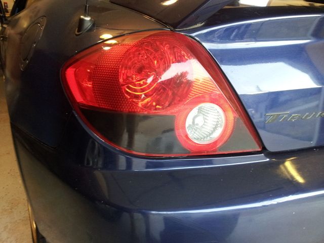

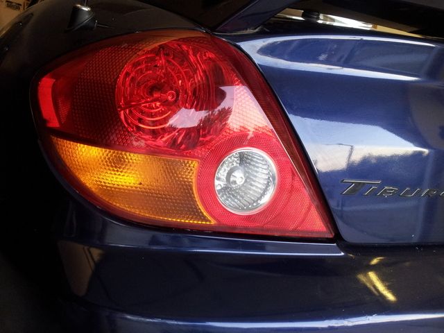

I was gone all weekend, but was still able to make a little bit of progress. Last night I decided to undo the awful nightshade on one of the tailights (one was normal, one was like this). I used acetone to remove it, then polished by hand using Meguires 205.

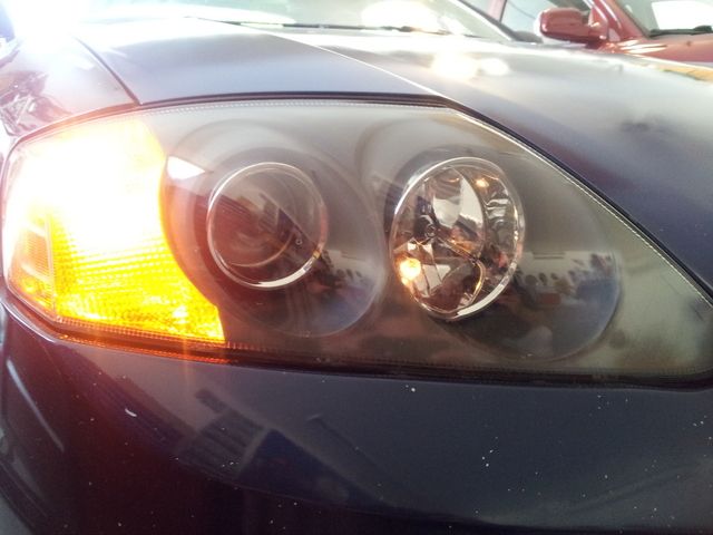

I also attacked the headlights, but got a little too crazy with the wet-sand paper, and have made some more work for myself on the driver's light. Need to pickup some more super-fine wet sandpaper to fix that. It's clear, just slightly foggy. I just used the PC polisher on the passenger light and it cleared right up. I should have used that first on the driver's light instead of going full-out wetsanding.

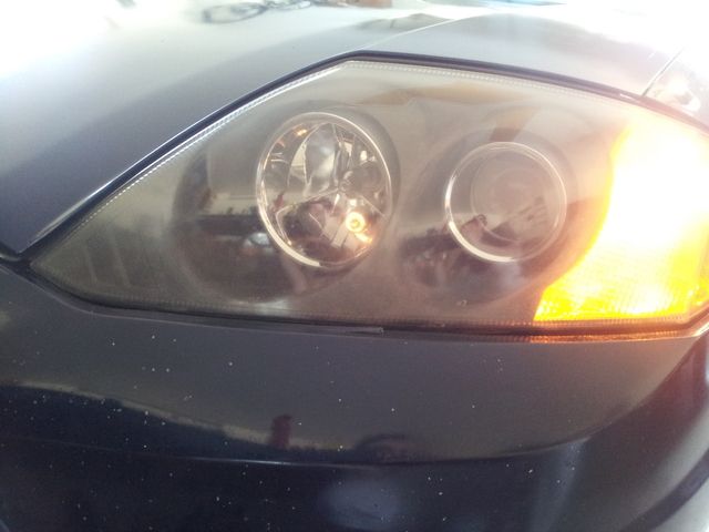

Headlights good enough for now. The passenger side was just done with the DA and some compound. For the driver's side I did wetsand with 320, 600, 1500. It was bad. Then I compounded it with a yellow pad, and polished it up with a green pad. It could use a little more love, but it is good enough until I get to the point of compounding the rest of the car. Currently trying to figure out how bright of LED city lights I should order.

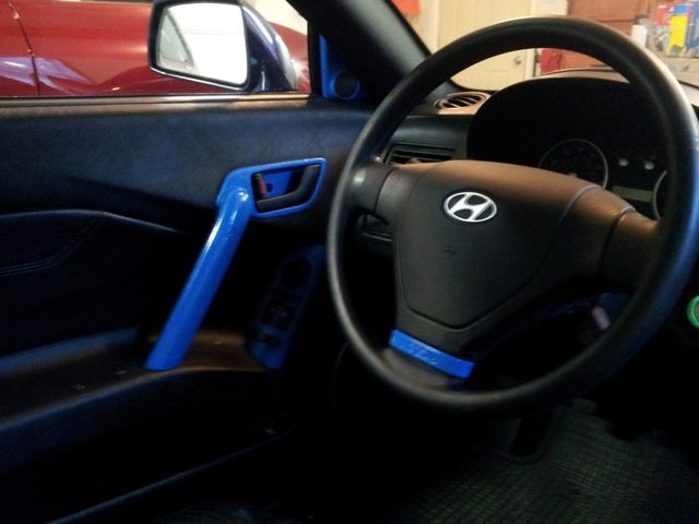

Started getting rid of the blue. I used Duplicolor Trim Paint to turn them back to black, after some graffiti remover, scrubbing, and wet-sanding with 320/600/1500 grit. I still want to replace all of it with the metal pieces, but this at least buys me some time to get around to that without shuddering every time I see the inside of the car. Only got the passenger side last night, but hope to get the driver's side done today/tomorrow.
Here's a comparison picture of the two right now.
