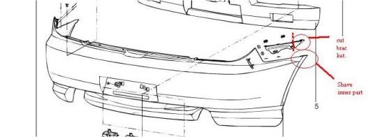

So fenders are rolled, you are lowered, and you still rub. Well it most likely comes from your Plastic Fender Liners and/or Rear Bumper to Fender Bolt. This is pretty self explanatory but here are some visual aids;
