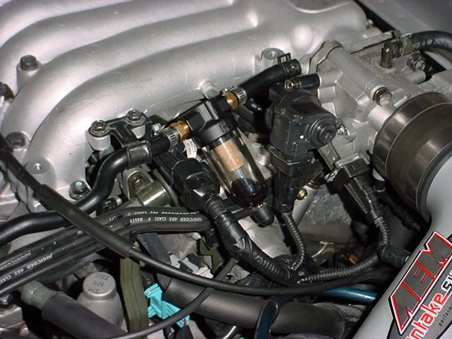

Alright guys but i don't want to vent to atmosphere. I want to create a setup where i can reuse the oil (especially since i'm F/I and i'll be venting off more of it.) That way i just empty the tube right back into the oil tank. Also dragging it on the ground is messy as all hell.
I'll let you know what i do today and show you pictures... maybe you guys can make some suggestions.

Ok thanks guys just a few more q's.
The valve is just that hex thing right before the nozzle on the top right of the cover, right? And I can just unscrew it?
And don't I want to move the rear hose somewhere because even if it doesn't need to go through the catch, it should be dragging instead of pressurized, right?
And since I don't really feel like dragging the lines, and I already ahve everything installed, would it be best to just put a mini filter on the other side of the catch can? And keeping the rear cover goign to the catch can wouldn't hurt anything would it? Is there a valve or not on the rear as well?
