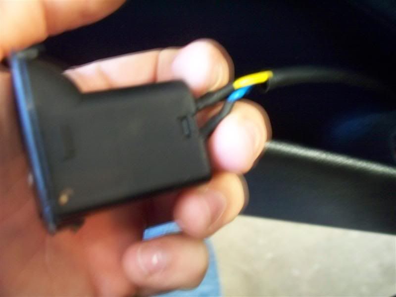

Step 1:
Unless your really talented.. or you've had your switch off before, your going to want to remove the door trim to get behind the switch and push. Follow the diy guide for removing your door panel if you don't know how. Because I'm lazy, i decided to just pull the switch out without removing the trim.
After you get the trim taken off, unplug the switch. Attempt to pop it out of the door panel. It takes a lot of pressure and i believe there are some heavy duty clips holding it in.

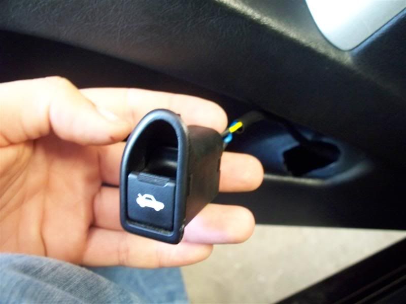

Step 2:
Notice the two clips on the side of the switch. Try to stick a screwdriver and pop each side off.

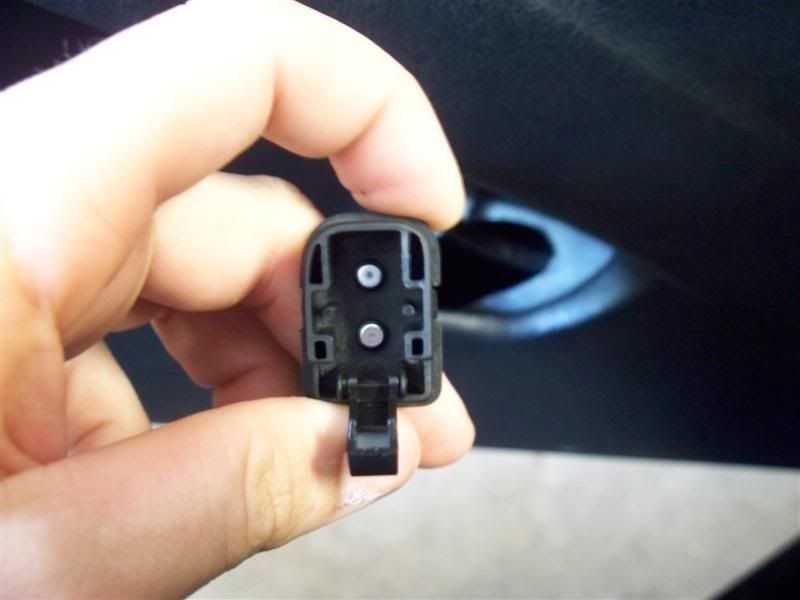

Step 3:
CAREFULLY open the switch. There are springs that will fly when you open it if your not careful so be alert.

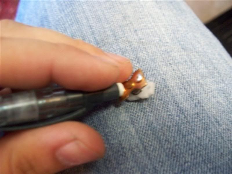

Step 4:
Notice the 4 total contacts on the switch, get a pencil eraser and go to town cleaning the heads. You probably wont get the marks all off but give it a good scrubbing.

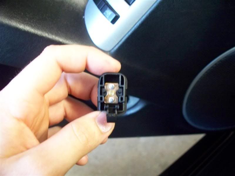

Step 5:
If you were having trouble with the switch randomly going off or going off very easily, then check the two springs on the side. Make sure they arnt worn down and squished, you can pull on them a little to restore tension. (I took the springs out in the picture)
Step 6:
Replace all your parts and put the switch back together. Test it and if it works, put it back in. If it doesn't work, you can try cleaning it some more.
