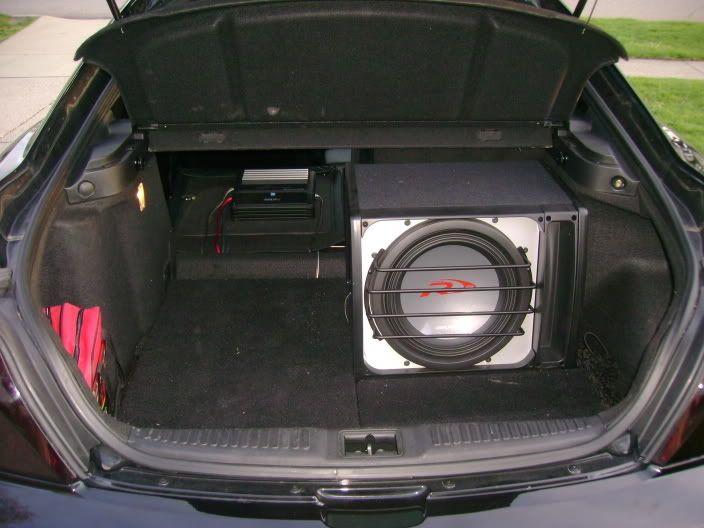

Thanks for everyone's help. My tib was easy with one 12" alpine r', but even though I've wired several HU and amps, I've never done more than one sub. Years ago I even remembered OHM's law.

You missed the earlier posts in this thread. I had a 12" Alpine R' in a sealed box with a 800rms mono amp, and a 600rms 4 ch to my 6." and 6 x 9" alpine speakers in my tib. This is for my Nissan Titan. I have the king cab and the best made box (goes under rear seat) only allows for two 10" subs with a mounting depth of less than 6." and an amp rack. The alpine r' 10" subs needed 7." to fit, si I have to get the KICKER CVX10 D4 10" because the only need 5 15/16" mounting depth.

Here's the Titan Box, and here's the back of my tib. My 12" Alpine R' & sealed box sat next to my trunk mount metahnol.
