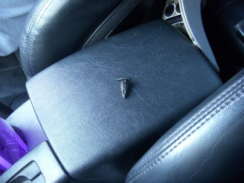

ok so there are two of these annoying little screw like things that i basically just broke off 'cuz fingers aren't supposed to loosen stuff like that... here's what they look like:
and here's what i did to remove them:
i broke one and ruled them both obsolete, the plastic surround trim pieces hold the headliner in just fine without those little guys, but if you can get them out and back in, go for it!
