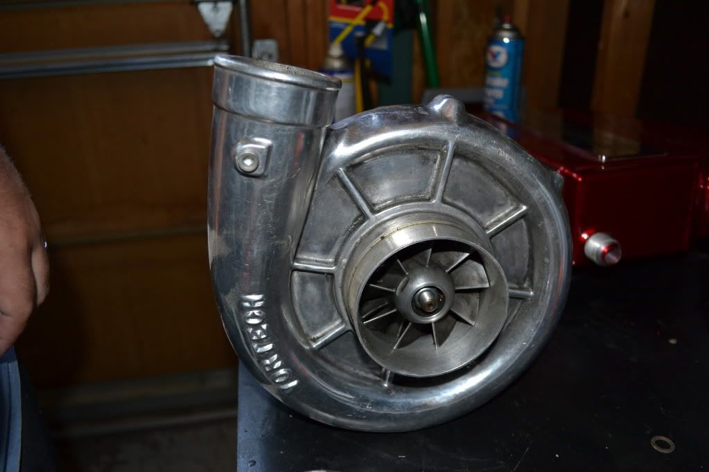

BOOM!!! goes the supercharger....... melted the bearings and cracked the internal oil housing after 10hrs on the road from Colorado to Washington State. Vortechs do not do well at 80mph for 10 straight hours. Good thing it's an easy system to bypass. Now comes the big decision, send it back to Vortech and get it rebuilt ($370+shipping) and keep trying to fix my hesitation issues or go a different route. I think I narrowed my problems down to the tune on the FIC, talked to a lot of people on here and elsewhere that are running the FIC and showed them the maps from it and the consensus is a bad tune. But I still don't know if that will fix the problem. I'm headed out today to talk turbos with the performance shop here in Spokane, talked to him a little bit Sat. and he's got some good ideas and a lot of experience. So I might be going turbo instead who knows. For right now though I pulled the Vortech and put stock injectors back in and bypassed the FIC so I'll keep it like this for a while till I figure out exactly what I'm going to do.
