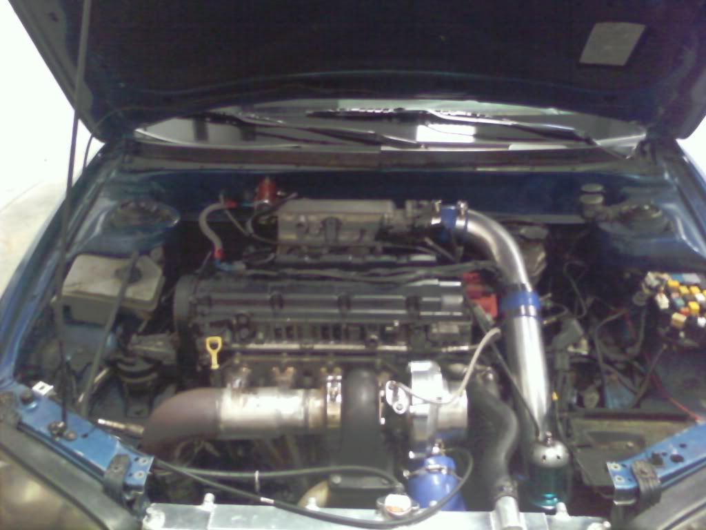

Here are some pictures of it on the race chassis with both he 5557 and 7076. Note that the exhaust will not come out the passenger front side of the car, but under and out behind the engine. Also the turbo and manifold will be made closer to the engine to keep stock radiator and cooling fans. This manifold was made for a 70mm turbo (really big hair dryer but you get the idea).
Pre Initial fitting on the engine stand. The wastegate in front of the manifold but now on the side.
Front View
Initial Test fit in the car
Car sitting outside at the dyno day with the PTE 5557
Up close
As far as power goes, just on wastegate pressure only (15 psi) we've made 331 peak whp. I'll post that graph when I get back to the shop since I pulled the wrong one before I left. But here's one of 328whp and 256ftlbs.
I have turned the boost up just a little not a lot no more than 4 extra psi, and yes 375 no problem. Here's a sheet @ 17 psi. 357whp and 286ft/lbs!!! With only 2 more psi and air/fuels still needing to be cleaned up!!!!
