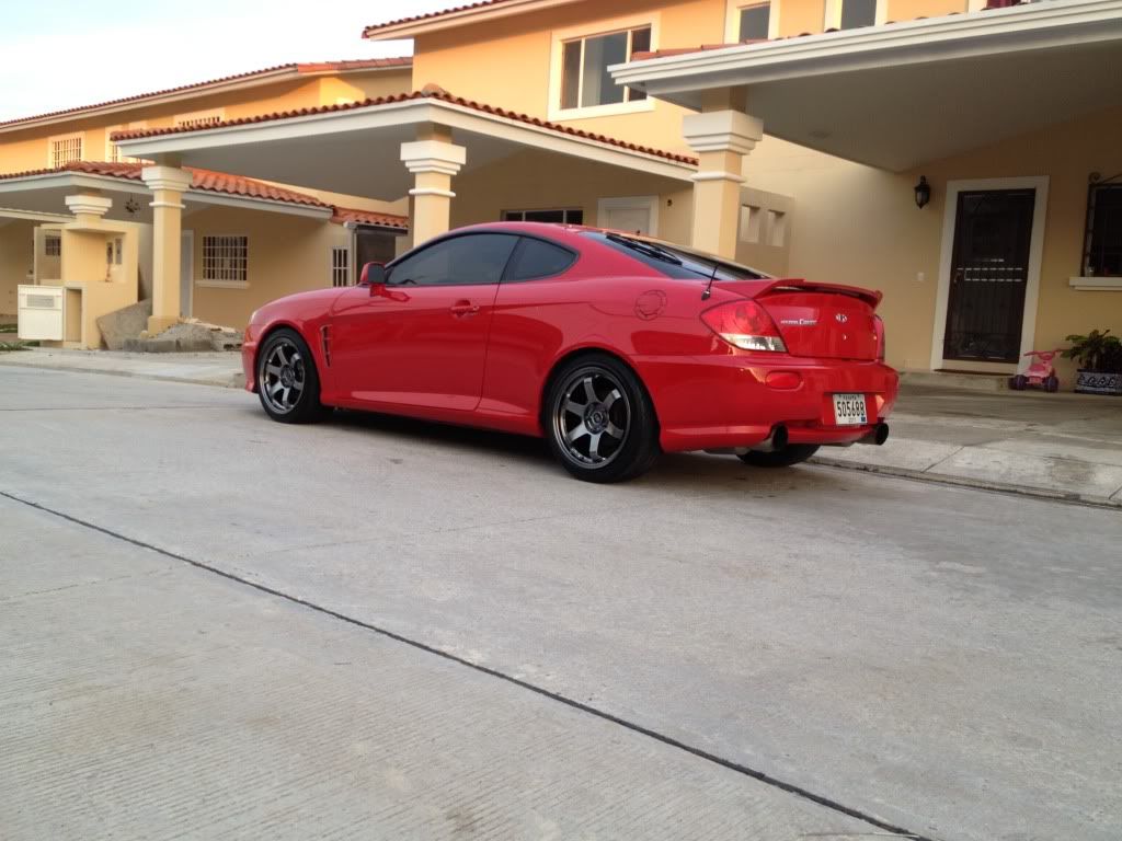

These are some fresh pics from the past weekend in front of my house, you can see the Toyota behind the Tib in the 3rd pic

I just put them about a month ago and took great care not to scratch them , however im pretty sure they will scratch with time
Thanks man.
Overall fitment is great.
At the front wheels no rub whatsoever before and after the Teins
At the back i put some 6mm spacers more of a "flush" look. At stock height it wont rub at 99% , its fine unless you drive thru some lunar crater
With the Teins it rubbed a bit so I had to roll fenders.
I believe 17x9 is the widest you can put in the back without spacers, the rear rims are milimeters way from the suspension. I went with 17x9 size basically to keep weight down and have enough deepness for the concave effect
