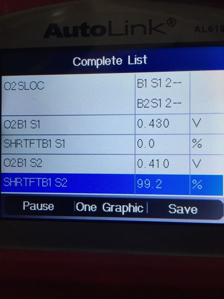

So I just got home and I was sitting in neutral and the rpms were bouncing around. I got some live data while this was happening.
With the car running, the TP jumped from 14% up to 60% and back down. It did this a couple times.

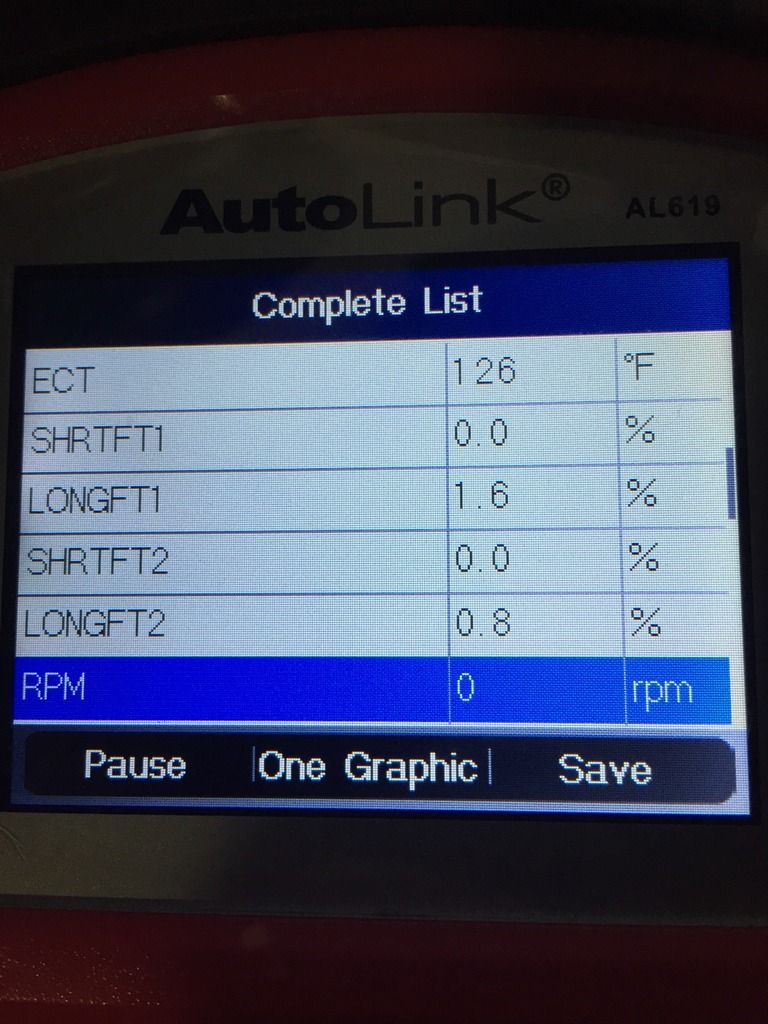

With the engine off the LongFT1 is 1.6% and LongFT2 is 0.8%. Both ShrtFT1 and 2 are 0%. The pictures below are before the rpms started jumping. The car was off.
I'd say there's something up with the TPS, it shouldn't jump around like that. the MAF did seem a bit low, but fuel trims were spot on so I wouldn't worry about it for now.
was the replacement TPS an oem or aftermarket sensor. as stated many times in the past, these car's don't take kindly to aftermarket sensors.
also, is it just me or is that thing misfiring like crazy
So, my test you did the TPS was fine, but then it's jumping around? It should not do that, it will mess you and the EVU up.
Data looks OK, rarely do you get full range out of the TPS.
New parts may read a little better.
Keep us posted.

Your MAF value seems low. check if MAF volt in your live data changes with RPM change.
Clean MAF sensor (use CRC cleaner) and clean connector contacts then put some dielectric grease on the connectors. If that doesn't help then disconnect the MAF connector and see if it idles better.
